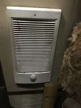

[Hearth.com] Back up heat in my boiler shed. I installed one of these
