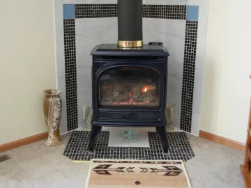

High use of mercaptan to make propane have an odor seems to leave something after fuel is burnt. We installed a direct vent stove that has a standing pilot so needs no power in case of extended power failure. CL digging kept the total cost down. Less than $500 for total install with ceramics etc. [Hearth.com] Backup Heaters and Fumes
