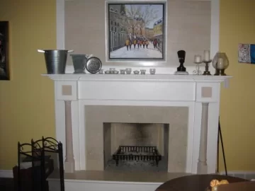

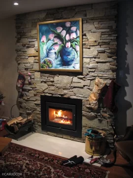

I was a big blazing fire guy too. Here are before and after pics and you can decide for yourself.

How about a few pictures? Good luck!
Jocam, Looks great. Would love to have something that nice. We have all brick and its just a little too 1970s for my taste.
To be honest, the before picture doesn't look too bad either.
