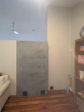

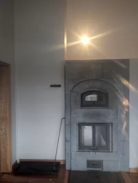

Hey Folks,
We recently moved into a home with a custom built soapstone masonry heater, circa 1988. My guess is that it was a heavily modified tulikivi kit based on the design features. I was not able to obtain design or as built drawings of the unit. My family just adores this heater. The heat it gives off is incredible.

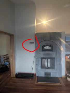

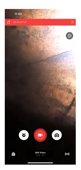

This year, we had a cleaning and inspection that revealed several small cracks in the terracotta flue. I started reaching out to masons and chimney repair companies to see about fixing this. Most turned me away simply based on the design of the flue. The issue is that this unit was designed with a flue damper, which is built in the the parged CMU chimney wall. Apparently, this is no longer acceptable in the fire code. So this is not as simple as dropping in a new SS liner. Other companies rejected the idea that we can simply replace the terracotta liner without addressing current code violations.
The current contractor I'm talking to is a little weary to make modifications. He suggested getting in contact with a current tuliviki rep and seeing if the manufacturer recommends installing a flue damper. This could potentially clear all parties of insurance issues if something were to happen in the future. The plan would be to install an insert and modify it to fit the current design. His other(scary) alternative is to rebuild the entire chimney.
I was able to contact the original builder. He is now retired, but suggested that we can just close up the flue damper. The unit will not retain heat as well as it currently does, but could simplify the fix. I did a little digging and that some European countries do not allow for flue interruptions, and masonry units are built without this feature. I'm not a huge fan of this, but could be the only way to prevent a huge expense and construction project.

Most pressing is the failed clay liner. Do you suspect a chimney fire? How tall is the chimney and what size the clay liner? Is there an accessible cleanout? Does it meet 2” clearance to combustibles code?
The damper is just one piece that shouldn’t be a showstopper.
No, don't suspect a chimney fire, but it doesn't meet the 2" clearance in the attic space. Chimney is a two story. We have a sister unit in the basement that we do not burn. Two 12" flues- same damper setup in the basement. We close the flue damper once it has burned completely out- my understanding is that it helps the unit retain heat.

Yeah the damper is there to keep the heat from escaping up the chimney after the fire is completely out as well as keeping the cold air from falling down the chimney. I can see why it could be a carbon monoxide danger if it was shut while still having coals.
