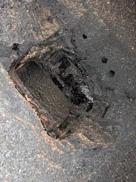

And that's when I decided to look at the other side of that hole that was plugged. It's missing a row of bricks and it's not parged, so it's like a little round gap in the smoke chamber and the side of the decorative brick is pretty black and the only thing between the room and the smoke chamber. That brick also gets warm during fires.
See the attached photos.
I'm assuming this isn't really a good thing. Is there any immediate danger or should I get some kind of extra brick put in the back and parged?
Even if I take the damper door off it's kind of hard to access this area from the inside. Even if that brick that was put in was removed I'm not sure this could be fixed from the outside (at least the parging)
I could probably cut out the whole damper with a sawzall or grinder wheel like other have done, so I could stand up in there, then switch the damper over to a newer top mounted one with a chain. Any downsides to doing that?
