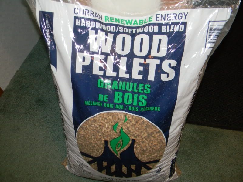

I have been having some issues with my PS-35 this year and a bunch of you nice folks have gone out of your way to try and help me figure out what the troubles were. After many different suggestions and trying almost everything involving the mechanics and cleanliness of the stove I decided to look at the one thing I was trying to keep constant through the whole ordeal......the pellets. I installed this stove in December of 2011 and we have purchased our pellets from a local supplier until today. I went to Lowes this morning and picked up 10 bags of Green Supreme pellets. I really like dealing with my local small businesses but if the product they sell doesn't work for me then I have no choice but to go elsewhere. The ten bags should be enough to make it through a week and give me a much better idea of whats going on. My basic issue to begin with was having to close the feed gate all the way down to get the stove to function. With the gate open to it's normal position I would get a flame that would touch the top of the stove most of the time and was quite lazy. It was also very dirty and the ash needed to be taken out of the stove surrounding the pot every 3 days. The pot had to be emptied at least once a day due to a clump of ash that would build up and begin to block several of the air holes. I also had to clean the stove pipe every week on the horizontal run to keep it from closing up. I would take about 1.5" of ash from that pipe every week. Low air flow was suspected but I know how I clean this stove and I do it religiously every Sunday. I kind of like doing it. With the Green Supreme pellets I now have my feed gate open just a touch more than I would have originally and the stove is working better than it ever did. It lights quicker with way less smoke and the flame is more consistent.
Now for the question,
Are my pellets just a bad batch or did they take on some moisture? I bought 2 tons this fall (only use about 3.5-4 tons total to heat our 1500 SQ FT home in upstate New York) and we are now down to about 25 bags. We used these same brand pellets last year with out too many issues. I store them in a shed on pallets. There is ventilation in the shed but no way for them to come in direct contact with rain or snow. They seamed to work OK for the most part in the very beginning of the season but we quickly started having issues with the stove once we really started to use it full time. I notice the ash from the old pellets likes to "stick" to things inside the stove like the ceramic cover on the thermocouple. It's very black and course. If it's just bad pellets then I will suffer through the rest of them and buy the Green Supreme pellets from now on. If they took on moisture, how long will it take before they will dry out enough to be used? We keep a 10 bag rotation inside our house. We use 2 of the 10 bags and bring in 2 more. I like them to come up to room temp and stay that way for a week before we use the bag. I plan to build a garage but that won't happen until next year. Is there any way to moisture test the pellets? I though about taking a sample to a local fertilizer/grain/feed business that I deal with on a daily basis (I work on a farm) and see if they could test them with the grain moisture tester they we use to test our corn and soybeans. Not sure if it would work.

This statement above is very telling for me. If there was a problem with moisture, you would be having issues with it regardless of how strong you were running the stove. The fact that these pellets were OK at the beginning of the season lends creedence to the fact that this is probably not a pellet issue. If your pellets had gotten wet, there would be no question, because they would no longer look like pellets, but more like saw dust or wet clumps. As for a bad batch?.......When you truly understand how pellets are milled, you will know that "bad batches" come in increments of tons and tons. It is almost impossible to have a bad batch somewhere in the middle of the pallet, or even more unlikely to be from bag to bag. It is very difficult to diagnose a stove problem without being there, but I highly doubt this is a pellet issue. What brand are you burning anyway?

I wasn't implying they they had gotten wet. I have dropped some pellets in the snow and they inflate in a matter of minutes. I was wondering if they were above there intended moisture. Like 8%-9% instead of 3%-4%. These are the pellets that we used last year and so far this year.

As of right now I have a functional pellet stove by doing nothing more than changing pellets and cleaning like normal.

That is exactly what was happening to me. I will search for a higher quality pellet. I know of a couple of places locally that sell pellets but I am not sure what kind they sell. I will find out and report back with a name to see if it would even be worth trying.

24 hours later I still have a pellet stove that functions as it should. I would have never thought that there could be such a difference in pellets. I know that these Green Supreme pellets aren't the best pellets in the world but they are worlds above the Curran pellets I was using. Next week we will be trying Cubex pellets and the week after that we will be trying Logik-E pellets from yet another local business. The Cubex and the Logik-E are both from local small businesses so I am looking forward to being able to support one of them if they work out. Dealing with Lowes isn't really for me.
By the way, I have 27 bags of Curran pellets for sale if any one is interested.....best pellets I have ever used.
