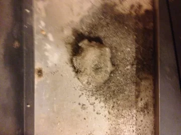

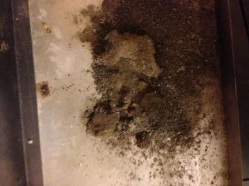

I'm actually only running the heatilator right now it replaced one of my Jamestowns and the other needs to have both fans replaced when I get enough money to fix it [Hearth.com] Heatilator CAB50 excessive ash buildup in pot this is what the ash build up looks like [Hearth.com] Heatilator CAB50 excessive ash buildup in pot [Hearth.com] Heatilator CAB50 excessive ash buildup in pot and this what happens when I touch it and I seem to get one of these after about 2 or 3 hours of running
