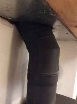

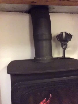

The flue is 10metres long, as the stove sits proud from the fire place it has 1 straight black pipe and then 2 45degree bends. They are installed the correct way round and all connections are sealed with vitcas Fire cement. [Hearth.com] Bad smell coming from my flue??[Hearth.com] Bad smell coming from my flue??
10 m is pretty long. Once the black pipe enters the existing (exterior/interior?) chimney what's there? Is is clay lined masonry, steel liner or chimney pipe? Whatever it is, what size is it?
If you are seeing dripping creosote the flue gases are too cool either due to wet wood, cooling too much before exiting or a combination of both. BTW liquid creosote is bad stuff. Google stage 3 creosote. This a problem that's more than just a nuisance.

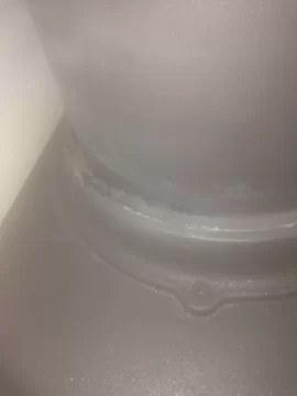

We are fairly exposed and we have a really strong draw. Originally it was running down the back wall where the flue goes through the registry plate and the smell persisted for some time. We would have to exit the room, close door and open the windows. It hasn't done it for some time and now it seems to be leaching out of the fire cement where the black pipe enters the top of the stove. I've attached a pic and not the best!! But I think you can make it out..[Hearth.com] Bad smell coming from my flue??
I would check your cap. The cap is often the weak link being the coolest part of the system. If it appears to be clean then it is either old creosote as I mentioned or possibly one of the connections in the new system has become separated or liner got kinked.
It looks like the plate around the black pipe is removable. You should be able to get a better look with it off. The liner should be insulated top and bottom to keep air (smells) from drafting down into the room and to prevent heat loss. That plate is a good start but who knows what else is there (or not).

Have to say this installation would never pass inspection in the US. The wood beam appears to be only about 10cm away from the single-wall pipe. That is asking for trouble. Are there other combustibles within 50 cms of the uninsulated pipe?
