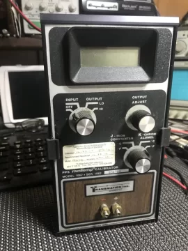

The mv might not be enough. I will get a pic of the tester i use
