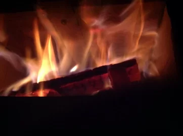

I had a 6 log fire going last night and the top fire baffle was glowing red where the air holes come out of the secondary's. You can see the little red lines in the pic. Now they are new baffles that I put in yesterday. They were replacements for ones that I had that were shorter. Do you have to break in baffles or the glow is because it's getting nice and hot for the secondary's. Which is a good thing. My old baffles never got to the point of glowing. The new baffles that napoleon replaced with seem much heavier then the old ones. The inferno stove top magnet topped off at 600. I had it at 600 before with the old baffles but never got that glow.

Normal. Probably better wood than you had before combined with better insulation value in the redesigned baffle boards. Mine glow on the 30-NC sometimes. For seven years now.
Oh ok, I thought that maybe I had the new baffles to hot for its first fire and the glow was a bad thing like moisture evaporation to fast. The fire lasted 5 hrs and there was hot Coals 6 hrs later. Which I never had the stove do before with the old baffles. Hopefully the new design of the baffles will run my stove much better and longer.

I am glad to here that it is a good thing. The only bad thing was my house was 78deg for 24 hrs. LoL

LOL, to me, ^^ THAT is also a good thing! ^^^^:)
With my Jotul F 600 woodstove my magnetic thermometer can read down as low as 400 F on the top corner where the manufacturer says to put it and the front most air tube on the secondary burn unit will glow red. I'm guessing the fire shooting out of the tubes behind it are super heating it.
Well it is baffling...
My Napoleon 1450 does the same thing.
