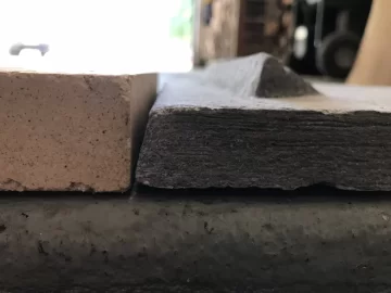

I see what you both mean with regards to the insulation value. I’ve attached a photo. The firebrick is actually thicker by about a 1/4 to 1/2 inch (didn’t measure) than my baffle.

Note that the photo is of the (1) new baffle I have on reserve. Not the beaten up two.
