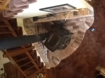

After reading these forums on an off for a few years and obsessively this past month, I'm doing my first post. (As a matter of fact, my first post ever on any discussion board.) Anyhow, after 15 winters of using my old VC Vigilant (1977), a state voucher is pushing me over the edge to get a new stove. Clearance issues on my corner (quarter circle, 58" radius to brick, see attachment) hearth has me restricted to the Napoleon Banf 1100, P.E. Alderlea T4, or Quadrafire Explorer I. (As far as I can find out there.) I think it'd be a push, without hearth addition to increase to the 1400, T5, or II. We'd like to maintain the cast iron look.

The Vigilant is a strong heater. I think you will be disappointed in the lower heat output and burntime with a smaller stove and would recommend going up a size to at least 2 cu ft. The Alderlea T5 and the other 2cu ft stoves may fit ok. With double-wall stove pipe they can go right up against the brick if the brick depth is 4". The clearance for all of them with dbl-wall is around 4" in the corner, but that is to the combustible wall behind the brick. The Quad Explorer II also has a close clearance with double-wall stove pipe and is less deep. This makes it mostly an E/W loader, but with a slightly larger firebox. It is a very good looking stove.
Thanks for your comments. Today also I talked to a local friend who has a firebox of only 1.5 cu ft, and he regrets getting such a small stove. Two people giving thumbs down in one day has me upsizing. So I'll have to see if I can squeeze at least the next size up (Banff 1400?) onto my existing hearth or just get excited about determining how to aesthetically extend the hearth.
