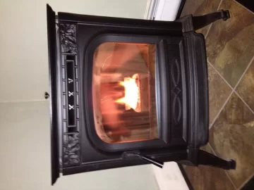

was pretty dirty. I use a cheap Ryobi laser temp gun I bought at Home Depot to locate drafts in the house to get a temp reading from the blowing air. It's usually reading over 400. The flame looks small and way at the back of the burn pot.

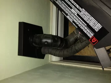

Is that room sensor supposed to be coiled up like that.
Ya. It looks like you could have made the bend with your brush and hit the ESP. It's also possible that ash got pushed over that downward turn and piled up at the bottom. You could try the leaf blower method to clean that out. You can get at the ESP by removing the left panel. It is located on top of the exhaust flue right behind the flange. You could at least pull to out (gently) to make sure it's not bent and give it a clean while your there.
Ya, I don't know where the ESP is in relation to the back of the stove...if that makes sense. I gotta assume it's in relatively the same location when looking in the exhaust outlet from the rear of the stove. If that's the case, it would be VERY easy to hit it with a brush coming in from the termination, particularly if yer vent is a short straight shot.
Ya it's possible you called it. It not far away from where the vent collar meets the flange. About 3-4 " in. Donn will need to pull it out and give it a look over. The other immediate possibility is that area is packed with ash.
I think that's the OEM spot. I ran mine like that for several months. Worked fine. I've since uncoiled it and hid it stealthily. I don't think it made a bit of difference. Of course, YMMV. If it's tucked UNDER the rear panel, I'd imagine that'd be no good.
I have a corner install also. It's just below the hopper height so we can't see it
