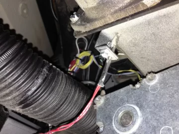

Barely any Heat Coming from my XXV after a Full Cleaning

Is this the ESP probe?

What do I do now? It seems attached and clean. Do I need to remove the vent pipe from the stove? If so how do I do that and I imagine I would need materials to reattach it to the stove. And I do need to look in to this leaf blower trick. Sounds absolutely hilarious to bring a running leaf blower inside a house
You need to pull it out and make sure it's not damaged.
Do a search on you tube for leaf blower trick. Lol ya defiantly don't want to do that in the house :)
Are you able to pull the stove away from the corner to inspect the exhaust flue and venting? It might be worth the trouble to get in there and check it out.
To remove the esp there is a screw seen in the pic holding it on by the collar. Remove the screw and gently try to pull it out. You may have to work it up and down a little to get it loose. It should come strait out if its not bent.
Once you get it out it should be strait. Also inspect for any hits incurred by the cleaning brush. You can post a pic if your not sure but it should be shiny and smooth when clean. A wet paper towel will do the trick.
Finally got that probe out and it looks un damaged and straight. That was a pain in the but. Corner installation makes it rough to get to anything. What should I do next?

You want to make sure that the exhaust flue at the base of the venting is free of ash. It sounds like the brush did not get by the probe so that area could be packed with ash. You can try the leaf blower method or if your feeling squirly disconnect the venting from the stove or pull the stove out to access that area. Yes the stove is very heavy! A friend comes in handy.
