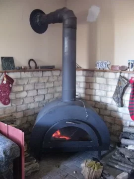

I am currently burning wood in an old half-moon shaped stove, see attached pic. It's huge, it's old and I imagine it's eating up all my wood that I spend so much time and effort cutting. The house is a leaky 100 year old farm house, the first floor is 900 sq.ft and the floor plan is not open, there are doorways from the 234 sq.ft den (where the stove is and where we spend a vast majority of the time) to the kitchen, bedroom and parlor. Heat from the stove makes it's way into the bedroom and parlor on its own but we use a small doorway fan to get more heat into the kitchen. There's a large laundry room/bathroom off the kitchen. There are also a number of large, though modern windows in all the rooms.

BTW, that is one weird stove you have - love it.

BTW, your current stove belongs in the Weird Stove Hall of Fame!

I love the looks of your stove. A few months ago someobdy posted a thread on here, he had a stove like that and was asking what it was.
When you are done with it, I will buy it from you, wonder what it would cost to ship to North Carolina.

I also remember that stove you have , I can't put a name to either.
