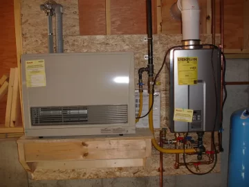

I am looking to finish about half of my basement. Our home is a ranch, built into a hillside, using blocks for the foundation. One side of the basement is garage, the other half is unfinished space that in the next year will become 500 sq/ft of finished space. My challenge is to heat it.
Initially I looked a installing a boiler and using hydronic heat, but that is too expensive. I'm considering a Monitor, Rinnai or something similar, but my main issue is uncertainty if this is the best means to heat the space. Attached to this part of the basement is about 350 sq/ft of addition crawl space. The crawl space was built using insulated block and poured walls.
We are having the joist ends/sill area in the basement area spray foamed, along with the crawl space where the plastic covers the dirt floor beneath it and goes up the insulated foam wall about a foot (this is to create a seal from moisture mostly). The wall that separates the basement from the garage will also be spray foamed, along with the ceiling of the garage area.
Will the concrete floor in the basement 'eat' heat? Will a floor unit keep the room warm enough? Is a wall heater a good option to consider? We live in upstate NY, not too far from the Canadian border. I'd also like to make sure we purchase something with a thermostat setting, perhaps one that can be set or controlled remotely.
