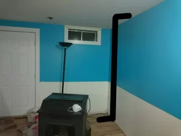

Hey guys,
I'm going to install a used St. Croix in my basement. The plan is to put it in the corner shown in the picture. It'll be right below the small window but venting through the adjacent rim joist. I'll have to cut a pocket in the ceiling to get to the joist. I plan to use an OAK and 4" Pelletvent Pro pipe (1 inch clearance to combustibles). EVL is fine, as is vent clearance to windows/doors. My questions are:
1. Is the inspector going to care that the stove is right under the window (there is plenty of exhaust clearance)? That below grade window isn't considered a safety egress is it?
2. Is the 1" clearance a sticking point if I do actually approach that? I'll have a proper thimble of course.
3. Is the inspector going to care that I'm taking a big chunk out of the rim joist? I'm aware of the code regarding holes in regular joists, but rim joists don't seem to be mentioned. The rim joist has no tension on it so it's not like it's going to fail, but...
Of course these are best answered by the inspector, but I figure I'd start here where there's a lot of knowledgeable people. Thanks!
