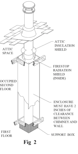

I recently purchased a house and there was a pellet stove in the basement with a 4" pipe going out the wall up a chimney. I would like to put a wood stove in it's place but I also want to tear the chimney down and put my pipe for the new stove out the roof. Is it possible to put a pipe through the floor of the upper level and vent out the ceiling or do I need to leave the chimney and vent there?
It would have to be chimney pipe but yes it is possible if you use the right materials. Is there something wrong with the chimney structure that would make you want to tear it down
It is pulling away from the house and I don't want to take the time and money to rebuild it. Thanks!
Keeping the chimney inside the house envelope will keep the flue gases hotter. It is always a good idea if possible. No need to tear down the old chimney unless it is a problem. If it is, remove it.
Yes, as long has the proper support and firestops are used and the chimney is chased. It will need 2" clearances from any combustible.

So, exposed chimney pipe, unprotected by brick or rock is ok going through the floor and attic?
It needs to be enclosed in any living space and all or the proper shields and pass thrus are used it is fine.
