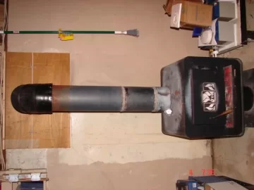

The pic is of my basement stove, with the insulated panel around the flue pipe. To put it back in working order, the insulated panel comes off and all the junk gets moved away.
