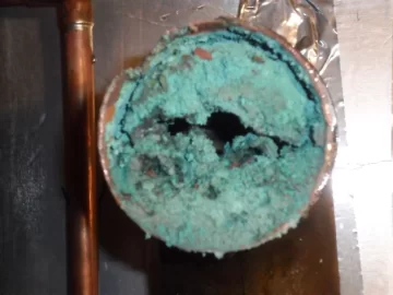

Well another idea that looks like it worked . I had to take out all my copper drain lines 1 1/2 and 3inch. I did not know what to do with old pipe so thought I make in floor heat from my boiler. In photo you can see I looped it threw the one zone in my house, Have a whole $40.00 in it. The fittings I looked up for ends 90 to 3/4 would cost me $115.00 So, I got a BFH. and smashed ends then brazed them up, 3/4 cross pipe is brazed also with brass. Air check at 120 Lbs. for leaks. Brass alot better than soilder. I insulated them and seems to work great so far. I used about 19 feet of 1 1/2 inch and 9 foot of 3/4. Seems should be at least 3 gal. of hot water under floor? I also made towell racks and grab bar for bath out them.
The one photo is why I took out pipes. Other is pipes I cleand up, other is floor heating.
