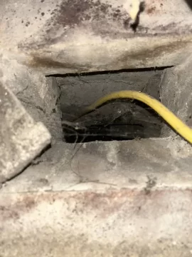

The fireplace in this house was hooked up with propane when we bought it. Would like to switch to wood. I can remove the gas line no problem, but noticed some things I dont have answers for. The chimney here has 3 ports that go to the main chimney top. In basement, is a boiler(1st connected to chimney), in basement is also another unused pipe for a wood stove etc (unused 2nd connected to chimney), and on main floor the fireplace. See pics 1268,1265 shows basement area and ash cleanout at bottom behind water heater

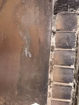

The insert is steel and the brickhearth was apparently built around the steel insert as it cannot be removed without removal of the bricks on face… it looks to be in lntact except the poorly sealed gaps between it and the brick (see photos). For the gaps larger than 1/2” like the floor there is about 1” x 1/2” areas need to be filled in. Which type of mortar would I use? Seems like most say no more than 1/2” wide gaps.
I have this cover on base for the assumed ash cleanout, is this top cover sufficient for wood burning or do I need anything else? Im assuming since there was an ash cleanout in basement for the fireplace that it is build to handle wood burning.
