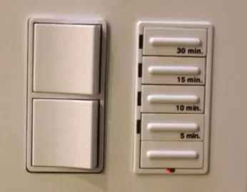

We also had an almost 20 year old bathroom fan that was so noisy it was like showering with a twin turbo prop in the room. And the mirror was still foggy when the shower was done. So we installed an Energy Star rated inline fan from a company called Fantech (broken link removed to http://www.fantech.net/bathroom.htm) . The fan is so quiet there is no audible reminder to turn it off, so we put in a timer switch. The fan is mounted in the attic with an insulated flexible duct to the roof. Both the fan grill in the bathroom and on the roof have spring dampers. Okay, not cheap but you can take the hottest shower and never even a molecule of steam on the mirror.
I don't know if this will work for your particular situation, but they have soffit and louvered vents for non-roof venting.
Also found out that our old fan was way underpowered for the size of bathroom from day one. Be sure when sizing this kind of fan that you use the CFM with .4 static pressure for duct losses.
Here's pics of the fan vent and the wall timer.

The alternative to the set time switch is the use of a dehumidastat wired in parallell with fan switch. In cold weather set dehumidastat at 30-40% the colder the lower, clearing the mirror in the bathroom should take less than 15 min. On line 120 volt
dehumidastats are available in the $15.00-20.00 range
