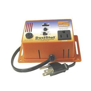

Eventually, I would like to use one of these line voltage thermostats with some duct work as is shown in these links> (let me know if it won't work since I performed the search)

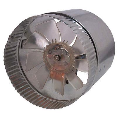

I tried the inline fan from HD. Result = VERY NOISY.

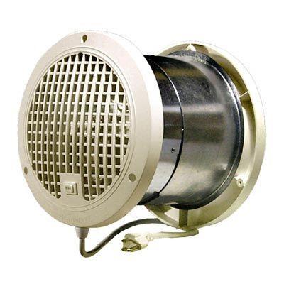

Does anyone have first hand knowledge of the noise level of the third item shown above? I hate to cut holes only to find I can't stand the noise & I was going to order it tomorrow. Thanks>
I use an 8 inch inline centrifugal blower with speed control. I mounted the blower far from the stove, in a box (sitting on concrete) that is a labrynth of different size compartments (like a muffler) and holds two furnace filters (before and after). It makes far less noise than the gas furnace blower.
I have 2 of these, one going from the stoveroom to the central hallway, the other from the hallway to the MBR. They're not bad on the low setting, on high, you know they're there, but its not annoying loud. My issue with them is that they don't seem to be working for my application. I can have the stoveroom at 80* and can't get the hallway above 65*. the air coming out of the fan into the hallway seems cool, not warm. I'm wondering if its moving too much air, too fast.
some of those cheaper ceilingbathroom fan models are really noisy and can vibrate too ,id go with the inline 6 inch inline not the ,mount it to a register assembly int othe floor and it should be quit bearable and still move penty of air the bathroom fans dont move of anything and are thrice the expense if thats your only purpose IMHO
