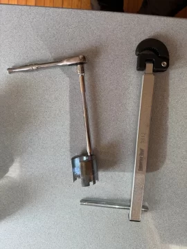

At the very least, require 2 special tools that cost $50 dollars to make it easier!
Superior Tool Basin Buddy
www.acehardware.com
Basin Wrench
www.acehardware.com
The first tool Basin Buddy disconnects the water connection which came off fairly easy but the larger nut that holds the faucet to the sink is rusty and will not budge using the basin wrench, ( a long tool with the black ratchet head to get in the tight space ) even after it soaked all night with PB Blaster.

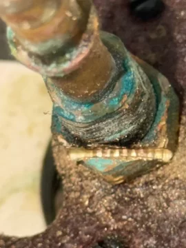

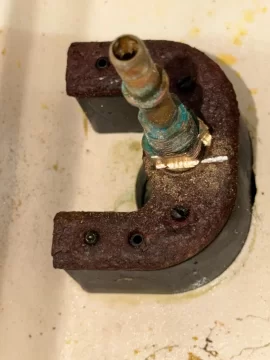

Taking the nut off that holds the horse shoe which holds the water spout in place not easy. After soaking the brass nut overnight with PB Blaster it still would not budge. Luckily I found a DeWalt Oscillating Multi Tool on sale and only one Lowe’s in this area had one left! It was the Tool, battery, charger, 3 cutting blades, 3 sanding blades and sanding pad holder, and cutting guide. Reg Price $259.00 on sale for $119.00
Therefore with this tool, it just bearly fit in the space to cut the brass nut that holds the water spout! So I made 3 cuts on the corners of the nut and the rest of it just fell off and the spout could be removed!

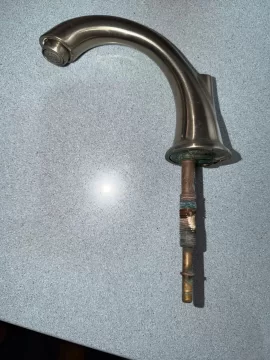

Pic 1 - Moen 3 hole lav faucet
Pic 2 - Superior Tool Basin Buddy with ratchet & extension and a Basin wrench.

Pic 9 - Brass nut and horse shoe holding water spout shows first cut
Pic 10 - Nut that will not budge that must be removed

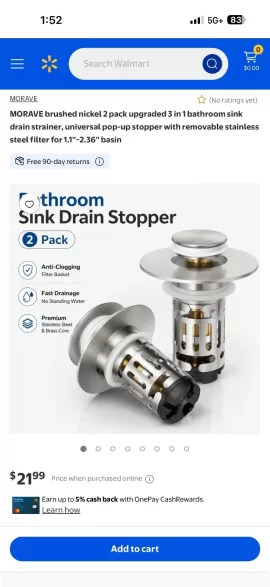

Just upgraded from the pop up to the push down drain stopper with the hair and lint trap.
