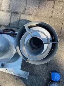

Thanks for the clarification, Bob. You're 100% right. I did a thorough inspection of the pipe and how it terminates in the stove. There is no way they can escape the stove, even if they have dropped down by accident or other means. I had the cap off a week ago and took a picture. It's attached.
