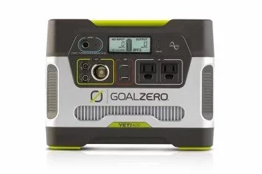

![[Hearth.com] Battery Back-up Question [Hearth.com] Battery Back-up Question](https://www.hearth.com/talk/data/attachments/168/168316-282b20f3fe1a4d78a951bf2a6c5fadf3.jpg?hash=OHvwQb19wY)
