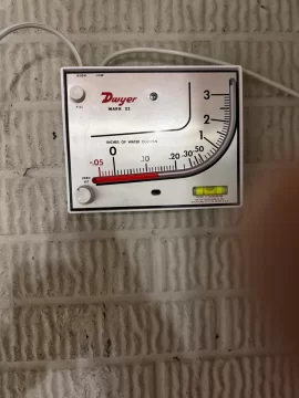

I will say though that I notice my Dwyer at time showing like .15. I can unhook it and it goes back to zero and hook it up and it seems like it is where it needs to be but then later that day it is back up to around .15. What settings are you guys running your dampener? My wood is seasoned about 2 years. I actually started mixing some wetter wood in because of the high temp alarms. Any suggestions is appreciated.
Did I read that right, .15?!
That is WAAY high!
I'm running 0.04 and that's plenty.
Do you have a really tall chimney or something?
Is the baro working?
Using large chunks of wood will help with the high temp alarm too, but ya gotta control that draft first!

I think there must be an issue with the Dwyer. . I can unhook it and it go to zero. Add wood at it be a like .04 where it needs to be for a long time. But when I go back 8 hours later to reload it is always then that high. At that point my unit is on 3 and needs wood added.
It is just I didn’t remember the Dwyer doing that last year. So something threw me with it this year.
It's a pretty simple piece of equipment, my guess would be there aren't any issues with manometer. Not unless it's been dropped etc.

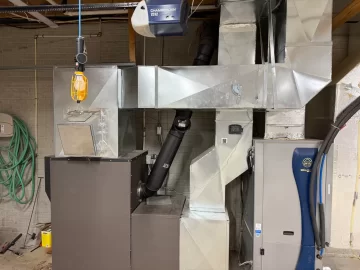

Do you have a cold air return setup?
Picture of your setup?
yes the heat exchangers are in place. I figured the Mano was just changing at the end of the burns. Makes sense. It is where it needs to be with a fresh load put in.
I will post more pics of the setup when I get back to the house. My stack temps seem to get in the higher 400s and close to 500 when it is reloaded. Lowers down to lower 300s after it gets to the lower c setting.
My cold air return is connected in with the cold air return for the rest of the house.

Wow, I've seen situations where the draft might surge to double the normal baro setpoint momentarily during a wind gust, but never triple, and sustained!
Those Dwyers are dead simple, if they are zeroed, plumb n level, they are accurate. (Assuming it has the red gauge oil in it)
It did recently have an issue with mine where it was reading falsely low...I usually check zero at the beginning of the burning season, but I forgot, and was having issues with setting the high alarm off, when it shouldn't have been.
Turns out the gauge was low on oil...which is weird because it hasn't moved one millimeter, and there was zero sign of an oil leak. Topped off the oil, zeroed it, all better.
Reactions: sloeffle

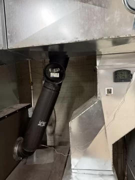

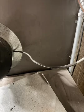

Here are a few more pics I just now took. The Dwyer reading was when I first went down to add a couple of pieces of wood to take the chill off. After throwing a few pieces in it dropped down more than half in just a few minutes as the draft started back up on the reload. So it may just be that it rises that much as the blazing fire dies down, but I didn’t remember it being like that last year. I also included a pic of where my Dwyer is connected in and a pic of my complete setup. Any other suggestions are appreciated.
Here are the pics.

I’ve had the piece of tubing I have inserted in the stove adapter plug up with creo and the manometer will act the way your describing.
Reactions: andym

Nice. You are monitoring temps. Having temp data helps a lot.
[Hearth.com] Vapor fire 100 trouble keeping up in the cold
I'm assuming the temp circled in red is plenum temp? What about the one with the arrow pointing to it? Return air temp? Do you use the stat to switch the Kuuma blower from low to high when it calls for heat? My house did not heat very well when I had higher volumes of lower plenum temps; like with how the blower system comes from Lamppa. I had to slow my blower down to get my plenum temps higher. I now run plenum temps between 100° (temp when the blower shuts off) to 137° and the blower is speed controlled. The hotter the plenum temps are, the faster the blower turns. Made a -HUGE- difference for me, but not all houses heat the same and what is optimized for us may not work for another. Our house is very inefficient and loses a lot of heat.

The smoke shows the stack and plenum temps. The little white gauge just shows the temp in the room and the humidity.

Our house was built in 2012. It is well insulated. But I am on a hill and we always have wind which could cause some of the draft issues for the chimney. But should be able to heat pretty easily.
Good point...I clean the tube end and my stack temp thermocouple every couple weeks.
