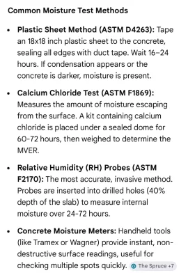

Here is a link. I see they have a product that would have been good to use first to seal it.
The 7399-1 adhesive was the correct one to use, but the question is was the floor properly prepared?
"FS420 FIRST STEPTM MOISTURE BARRIER is a liquid-applied membrane designed to control moisture vapor emission rate (MVER) including new or existing concrete slabs up to 100% RH. FS420 MOISTURE BARRIER is a water-based, one-component system that that requires no mixing and is formulated to block alkalinity in substrate."
Were the tiles coming detached from the adhesive, or the adhesive and tile becoming detached from the concrete? You may want to try to find an "expert" or contact Roberts to dig into the application considerations.

I was a floor covering installer at one time. That’s been 15 years ago or more, so things get foggy with time passed. I see in your contract that it says the installer was going to do a moisture test. If it was done and done properly, that should have pointed out this issue ahead of time. You probably wouldn’t notice with the naked eye any moisture problems, so that is why an actual test needs to be done. It is also important to acclimatize the product. It’s very important for installers to follow ALL manufacturers recommendations, because they will not cover the warranty if the directions were not followed. I don’t think this is a manufacturer’s issue; it boils down to if the installers did a moisture test. I think it’s obvious that moisture is present, so if they did one and installed anyway, that’s an issue. If they did not do a test, that is also an issue.
I actually do think they lied about doing a test before install becauase my wife and I told the installation manager who came to do the testing recently that we never saw them carrying that same case he has that moisture tester in. We also know for a fact that no tiles were aclimated since they came that morning and started prepping and installing within a few hours. Again we are noobs and did not take know of any of this or ask questions and all we can say is they didn't do it yet they claim they did.

Wow what a mess... For one the contractor should have done tests prior to quoting and installing. For any floor covering in a basement their should have been a subfloor installed, they make a specific one for this that has a honeycomb style backing to hold it up off the floor and let any moisture run out. They should have recommended a sump pump prior to installation, i have not been down in any new basement's lately but that was always a must in a basement. This is all 100% on the contractor and they should have to scrape everything up and fix it properly on their dime and any court would see it the same way. Obviously the person that quoted did not have a clue what he was doing since they underestimated how much flooring was needed, its usually the other way around and they overestimate.
Reactions: Whitenuckler
What do you do when they have already been installed, and you need to moisture proof? Don't you only have one chance when the concrete is unfinished? Now that they have used that adhesive, I'm not sure what would need to be done.
Razor scrapers to get what you can off then you can put down the moisture proofing. Will be a nice upper body workout for sure.
