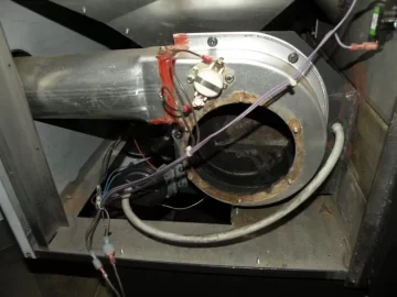

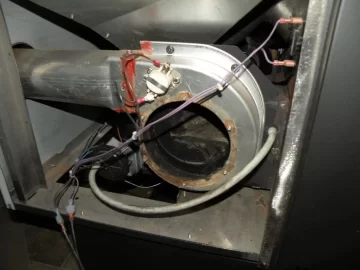

The stove has been burning dirty despite regular cleanings and a "break down/pull the combustion motor" cleaning at the end of last year.
It doesn't seem like it should be time for a cleaning so soon this year, but there it is- the stove is burning dirty.
We vacuum the exhaust vent out from outside the house regularly, etc. so we thought we were getting away with not doing the Leaf Blower Trick. We didn't have a leaf blower that would work in that capacity (long story) so we tried vacuuming from the outside as an alternative.
But the stove is now burning dirty despite it all.
I bought a Black and Decker leaf blower this afternoon, and some PVC fittings, and I'm ready.
I know that you guys disconnect the vacuum switch and/or remove the vacuum hose before the LBT. The trouble is, my manual is not overly helpful in this regard.
Here are two pictures. I can take more if necessary [Hearth.com] Beca Sunshine Needs a Little Help- Leaf Blower Trick [Hearth.com] Beca Sunshine Needs a Little Help- Leaf Blower Trick . What do I disconnect here?
the vacuum switch is the round black thing that small grey hose attaches to on the left . just pull the hose off at either end . done . just remember to hook it back up after .

I tried to remove the hose from either end but it's being a little stubborn... I wanted to make sure that this is what I do before I do it and I can't put it back. Just pull that hose off of either end, right? OK, here goes...
Did you get the hose off? Sometimes you have to twist it to break the seal, after it should pull right off. Worse case, slit the sucker, pull it off then cut it back to good hose when you reinstall it. It looks like you have enough hose. Remember, take pictures of the blower cleaning. (a video would be better) We love them!
OK, got the hose off, did LBT. Because Mr. Sunshine had supplied a piece of flexible plastic tubing that fits with another piece from the ash vacuum, I was able to hook the flexible tubing up to the Shop Vac and feed it into the baffles. I'd sucked a lot of that ash out of the baffles before the LBT so it wasn't all that dramatic, but it did put out a nice poof of ash.

EDIT: Ok, well, *all* of these sections Simpson Duravent interlocking pipes are moveable, and apparently have no sealant. There is sealant inside the stove, where the beginnings of the exhaust pipe connects to the combustion fan exhaust chamber. That's the red stuff on the pictures I posted. It looks like it's supposed to be this way.
