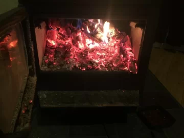

We have a older Century S131e stove and we use it to primarily heat the house. We are ending up with a large amount of hot coals after a few hours of burning. We are staying in the green on our temp gauge constantly now and we got a moisture meter and it's been reading about 10% when I check the wood. We get so many coals, it gets to the point we can't add more wood with out the coals spilling out. Are we doing something wrong or we will just have to clean the coals out every few hours? [Hearth.com] Bed of coals

When are you adding more wood? Are all the coals the result of the first load of wood? In my stove I load the stove, then let the load of wood burn down, including some time spent burning mostly coals. I don't reload until the coals have burned down at least a little. When I reload, I pull the coals to the front of the stove, make a groove in the coals in front of the doghouse air inlet, and then load more wood. I want to make sure the wood in front is in a position that allows air to pass under the wood and over the coals, to speed up the burning of the coals. If I leave the coals in the back of the stove and keep adding more wood, my stove will fill with coals the way yours has in the photo.
The coals are from the first load. We try to keep it in the green all the time. Maybe we are adding too much wood too often to keep it in the green.

^^^ This is your most likely problem. Let the coals die down a bit more before adding wood . . . the temp may come down some and be out of the green for a bit, but it's fine.
My first year or two I had times when I had a lot of coals . . . mostly because I was adding wood too soon . . . part of my problem was with thinking flames = heat and coals = time to add more wood. If a home has decent insulation you can afford to let the coals burn down smaller without a huge dip in the home's temps before reloading the stove.
Occasionally however you still may find excessive coals -- especially if the temps are wicked cold and you're forced to add wood sooner rather than later. A good way to maintain temps and burn away some of those coals is to toss a single split or two on the coals and open up the air. Typically I can see a huge difference in the amount of coals in a half hour or so.

As others have said, if you've got that many coals, you might want to rake them up near the air inlets and open the air up so they burn down. I find this is a good way to get another hour or so of good heat out of my stove if I'm not ready for a reload, or just have too many coals to fill up with wood for the night.
+1 on this as well. When we started burning, I was always tempted into re-loading too early. Those coals may not be putting out temps in the green, but they've got a lot more to burn in them. If you keep adding new splits to the coals without burning them down, you might end up with a mountain of ash in there, too.
