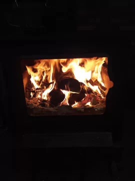

I thought I'd share my process for tonight in case it helps. I only put in a medium sized load last night since it was very warm and this morning I had coals at like 200 STT. I threw in some kindling splits to reheat everything then made a hearty morning fire 45 min later at like 8 am. When it was time to reload around 1 pm it was like 74 in the house so I decided to let it go out to clean out some ash and clean the glass.
Fast forward to 6:30 pm and its like 68 in here now. I had to decide whether to wait it out to 10:30 and start the overnight fire cold or make an in-between small fire to heat up the box. I almost always prefer a hot box heading into an overnight burn to speed up the ignition process and prolong the burn time. Less energy heating all that mass means more heat for me.
I loaded up a half ish load of bone dry maple and some kindling. After about 20 minutes we were here:
[Hearth.com] Been enjoying & learning from the threads[Hearth.com] Been enjoying & learning from the threads[Hearth.com] Been enjoying & learning from the threads
Bonus dog picture! Anyways like I've been saying, it takes off fast. Thatd why I was so shocked when you said it took you 1.5 hours to get to temp.
5-10 mins later:
After this pic I started shutting it down. As im posting here in real time I'm down to about 1/3 air with secondaries going strong. Ill probably take it down a little more then let it cruise as I only need a few hrs out of it and its a smaller load. That took what, 30-40 mins or so from striking the match to set it/forget it mode.
Sometime between 10-11 I'll have a very nice coal bed and a 300 STT ish stove ready to fire the overnight load. I still think it comes down to how good the wood/draft are. If those are top notch then it's just technique and time management really.
Hopefully all this helps. I'm happy to share more of the process if you'd like. Dont be afraid to let her rip! That's what it wants to do. Best of luck!
