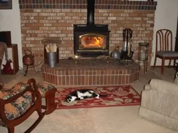

An insert is just fine, lots of folks absolutely love them, and there are some beauties available...but a freestanding is probably the best way to make most efficient use of the available heat from the fuel you're burning, if you have the room available to do a proper installation. A hearth stove is kind of a step between an insert and a freestanding stove...it's "partially inserted". IMHO, they all benefit from a blower kit (with an insert it's essential). A lot depends on how married you are to the wood mantle and surround, the required clearances from combustibles, and a host of other factors. Just as an example of one possibility, I'll attach a pic of what we did in our great room...sealed up the old open fireplace completely, had a raised hearth built, ripped out the old wood mantle and replaced it with brick, and ran the stovepipe straight up in the room & out the ceiling/roof, without using the old masonry chimney structure at all. The possibilities are endless. Rick
