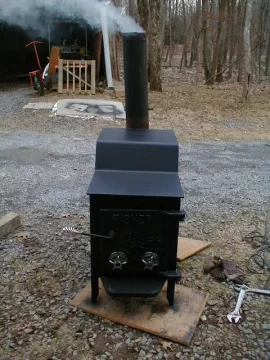

Here a Mapa Bear was wire wheeled and painted within a couple hours and fired in the same spot. I delivered it still warm in the back of a Land Rover and let me tell you a LOT of heat radiates off these when put in a truck with you warm ! I didn't have time to let it cool fully - it was a hot ride I'll tell ya.
