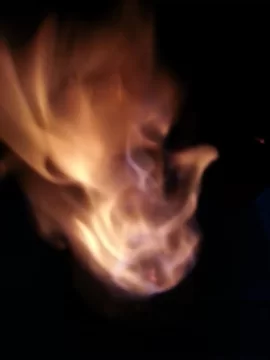

[Hearth.com] Best/Ideal flame color?
I've only tried 3 brands of pellets; so far all burn yellow but the Okie Platinums burn with an outgassing flame - primarily above the fuel.
