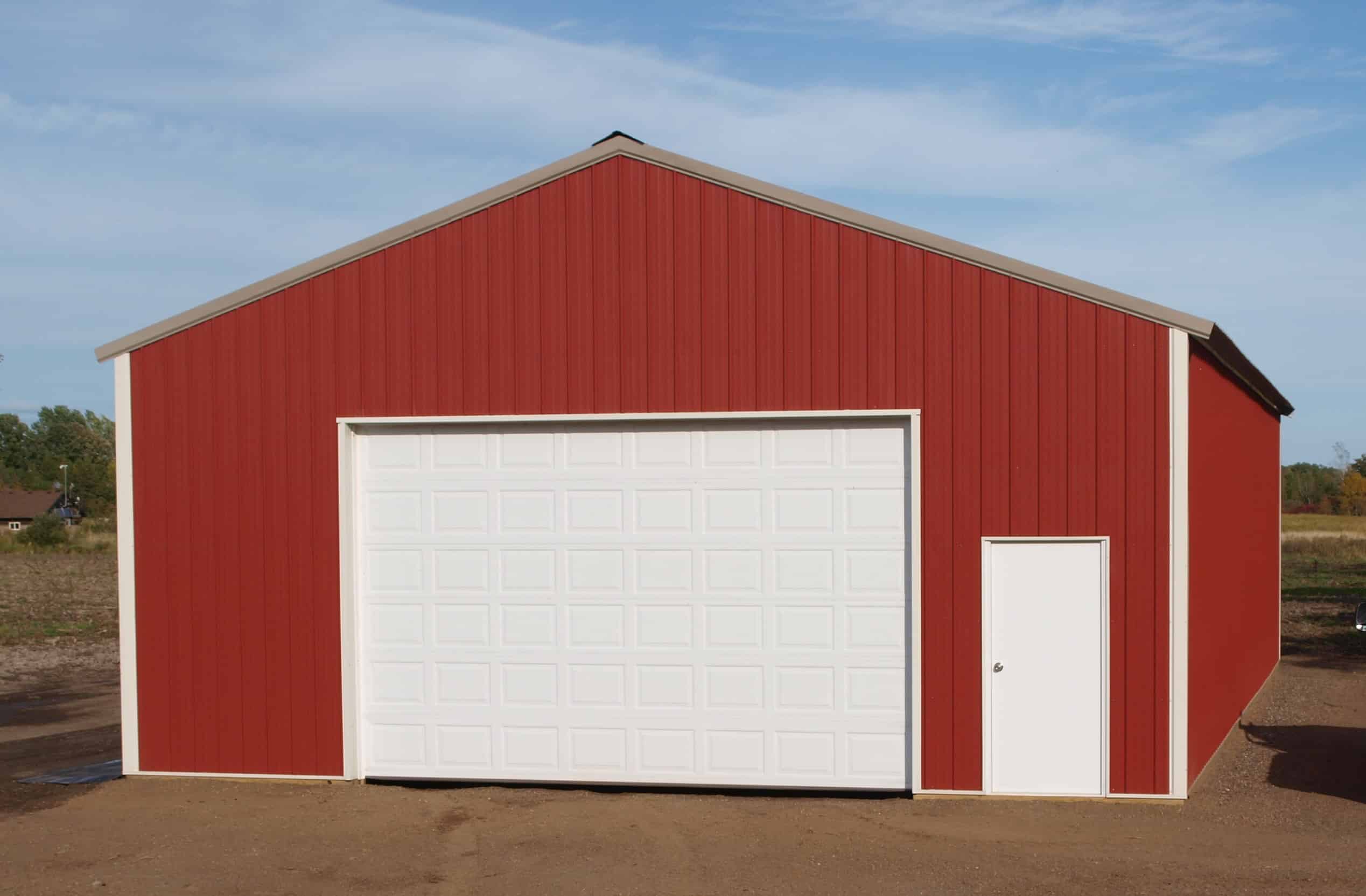

Hi guys. Been reading on the forum for awhile, but just decided to join up. I have a large home and sizable shop with all of it on propane unfortunately. I started heating the house with a fireplace insert last winter because the propane costs were getting insane and have been surprised at the amount of square footage I've been able to keep warm with a large insert and just burning good volume of hardwood. Was going to do a wood stove in my shop to get the shop to stop using propane also but then got to reading about pellet stoves and decided to head that route, so I don't have to walk out there multiple times per day to feed the wood stove.
My question is placement. The shop is a well insulated pole barn 60 feet deep by 30 feet wide. Where would you suggest the best place would be to put the stove to heat the space most effectively? Example like half way down one wall, in the corner etc or something else? I also am unfamiliar with how far away from the stove I should keep anything that I'm concerned with being damaged by radiant heat from the stove. Reason being is I have two custom boats in there and 4 snowmobiles, and the boats are painted. I'd be concerned if I placed the stove in the middle of one of the long walls for example that it could be too close to one of the boats paint and cause issues.
Sorry if this is noob questions but I'm new to pellet stove and trying to heat a shop with one like this. Thanks!

To tell you the truth I did not know what a pole barn was--thinking it was some oven building with some poles holding it up --sort of like a carport..lol ,,so I looked it up and they are beautiful..Now if it was me I would put it against a wall and blow it towards the doors with fans like another poster has suggested...but I would have my work table there too with a place for a coffee pot and a nice relaxing chair so that you can watch the pretty pellet stove window even if not as pretty as a wood burning stove ( I have my predilections here--I own a wood burning stove) and I found these pretty pictures on the net of some pole barns...Welcome to the forum...clancey
