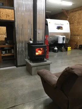

Best placement/location of pellet stove in pole barn?

I’m in my 30x60 pole well insulated with 14’ ceilings. You can’t have a pellet or wood stove that is too big for occasionally heating a space like this.

One thing to keep in mind, unless the shop is heated regularly(mine ran just like my home 24/7) you will be heating/warming up a big concrete slab, walls, ALL objects in the shop including the boats and sleds. A p68 or Maxx will heat your shop but you will have to run them on a more regular basis.

Yeah, but I can only get 60 lbs of pellets (or something like that) in my P68, so to keep up with an open shop on a cold day, I'd run out of pellets every day. With the 14 bushel hopper on that furnace, you could probably fill it once a week. And 100,000 BTUs would heat his place a lot better than the 70,000ish BTUs of my pellet stove.

The theory is the same except the furnace is rated for more BTU. It is also designed to hook up to duct work to evenly heat the area and act like a central heat unit instead of a large space heater.
Pellet furnaces have larger room blowers to move a lot more air. Mine has 2x800cfm blowers vs the 265cfm blower on my PP130. Most pellet furnaces don’t blow as hot as a stove, but move a ton more air. If adding some simple heat runs in the barn is an option a pellet furnace would be a great option.
As far as having to refill the hopper. The PP60 has a 60lb hopper, so you would have to add a bag about every day if it was left running. I know they sell a hopper extension for the PP130, but I didn’t see one for the PP60. It would be easy to make one though if you wanted added pellet capacity. I plan on building one to add to mine.
In my opinion I see a number of options. I can’t tell you which would be best for you because only you know what is acceptable performance for you.
1. Decide how even you need the heat to be and then place the PP60 accordingly. If you like the way it is working for you hook it up to a thermostat using a pellet miser and build a hopper extension to hold more pellets.
2. You could put it at one end with the idea that you could add another one at the other end if it doesn’t heat evenly etc.
3. See if you can return it and get a larger/higher BTU unit.
4. Add some ducts and used a pellet furnace
5. Try the PP60. If it doesn’t work for you, sell it and get a bigger unit.
