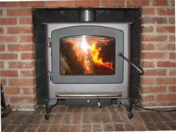

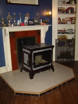

Big steel stoves in fireplaces are da bomb.
  • [Hearth.com] best stove for a big fireplace
