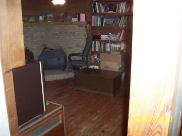

I currently have a Gatling wood stove that came with the house. It uses LOTS of wood. It is clearly an inefficient stove. My original plan was to run it until it died. These tax incentives have changed all that. I want to replace it with a stove that is efficient, as we do use it a lot, to supplement our heat.
I have had two masonry fireplaces in previous houses and a wood insert for a time, so I am not new to wood heat. I also have a chimney sweep friend, who isn't local. He like me agrees my wood stove is in a lousy location. That said, it has to stay where it is, which I will try to describe in the hope it helps you give me advice.
For some reason the folks who built this log house put in a brick chimney complete with flue tiles. It even has an ash cleanout door outside. Maybe they planned a fireplace but what I have now is a two year old 6" flexible flue liner in the flue that connects to the wood stove I mentioned. What really stinks is it is in the stove is in the corner of a small den that is off the living room/kitchen. I don't think I could have chosen a worse place for it to get heat to the living room and kitchen. That said, it is what I have to work with.
In the past we have put a fan on the den floor to bring air from the overheated small den to the living room and open kitchen. All rooms also have ceiling fans. I attached a picture that was taken with me standing in the living room. My goal was to show you the angle from stove to doorway but it is more pronounced than the picture indicates.

Welcome, SGF. #6 - New stoves have an air wash system, so "glass" stays quite clean. Helpful in monitoring fire status and throws some ambiance into the room. #1 - Englander makes efficient steel stoves under $1500.
I'd be looking at a cast iron stove with a true convection system and a 2 cubic firebox or more. The first stove that comes to mind is a Regency Hampton..oops, never mind. There "Large" Cast iron stove is 1.7 foot firebox. May be hard to get good overnights with that....although, you are in NC. Well, let me use that as my suggestion. The stove retails for $2200. For a little while, Regency has a sale where the blower option is free. It is a great quality stove and I have sold a few of them for folks heating small ranch houses. No complains about the heat, and even though I would guess a shorter burn time, no complaints on that either. I dont know of a decent quality stove with a blower that would look good in a log cabin for $1500.
Greetings SGF. Yes, a new stove is going to be a nice improvement.
In the 2 cu ft range, the Englander 13NC, Napoleon 1400 will fit the bill here. I'd also check out a Pacific Energy dealer and price out a PE Super27 stove which sells for about $1500. All of these stoves are top vent which would mean relocating the thimble higher. That would be a good thing in that it will allow flexibility for the install. Otherwise, you may be stuck to a very limited range of stoves. One that might work well would be a Woodstock stove, but it will cost a bit more.
Two important questions: What is the height at the top of the current flue exiting from the stove? How big an area are you trying to heat?
For evening out the heat, many of us have found that it works better to blow the cold air - towards - the stove. Try placing a fan on the floor in the adjacent room and blow the cold air into the den, fan on low speed. This will help establish a natural convective current. Hot air from the den will come in to replace the cold air. I think you'll see a 5-10 deg. temperature rise in the colder rooms using this method.

Looks like your current set up has a rear exhaust? If so it's going to cut down on your options unless you can move the flue up like Begreen suggested. What is the square footage your trying to heat? Looks like a small room, soapstone may be the ticket. A Woodstock Fireview or Keystone would look nice there.
