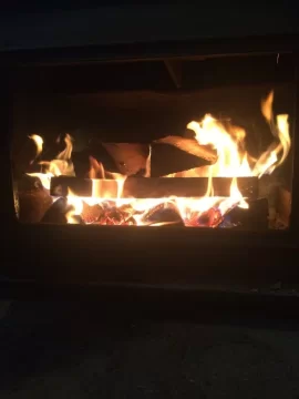

Here's a couple pictures from this morning

Might could be the wood ain't dry enough and what has been said about wood and wood dealers is all true. But that old stove can tolerate wetter wood than a newer unit if it's drafting ok and the wood is getting enough air. Can you confirm that the flue damper (upper right) is working? May be stuck partially closed? That you need to leave the doors open for a long time to warm the flue enough to get draft going could be a clue.
You also mentioned you took a look at the flue and it's clean, how is this stove installed? Is it simply slid into the firebox or has it been connected to the existing flue. Best would be a full liner from the stove to the top.
