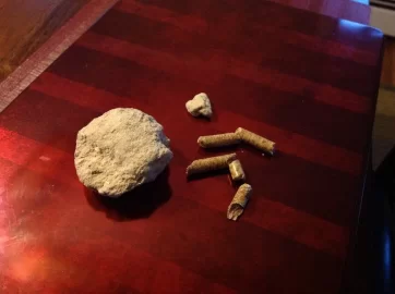

Woke this morning to a 58 degree house, and a pellet stove cold as ice. Pictured is what I found jammed in the hopper chute tray. Now my stove has a squeal which crops up with every open and closing of the feed door. More importantly, check your bags (Vermont Wood Pellet owners) for this type of beastie! Not a stone, but a compressed chunk of what appears to be wood pulp.
After having opened the back, I vacuumed out everything and cleaned the fines box. As I did that a pellet fell into the distribution blower. When I turned it on the pellet rattled as it spun, but thankfully only for about 10 minutes, at which point I guess it either disintegrated or flew out. What lube if any can I use on the auger motor gears on the back of the unit? Thanks for any info or insight as to eradicate this squeal.

sounds like there is something caught in the slide plate area. w/ pellets out of the hopper you can reach around in the area where pellets drop and fell for something still in there. Or may have something under slideplate.
Cleaned it all out inside slide plate and underneath by and in fines box. Afraid that the chunk getting wedged pushed down on the plate which is now rubbing on the underside. I wanted to spray the back of the auger motor assembly with some sort of lube, just for good measure and to rule that area out. I don't know what sort of grease or oil can be used though.
Oiling the motor assembly will not help. With hopper completly you can remove fines cleanout cover and pull the slide plate out and clean the slot that it rides in. When putting plate back in the stepped side goes up. If you lift the lever arm up slide plate will come out. There is probably stuff under the plate

If you youtube harman stove slide plate the first video by harman give you a cutaway view to help explain how slide plate works to make it easier to explain how to take it out. just lift the arm that actuates the slide plate and it will disengage it and it will pull out.

Got off the phone just now with the production supervisor for Vermont Pellets. When he saw the pic from the link you sent them he knew exactly what it was. Apparently it was from material buildup from around a die, which they had to have a machine replaced which prevents large chunks from getting through. He said he didn't think I should have any more issues, and that the problem had been identified and fixed. Offered to make it up to me, which I thought was very classy, but I let him know that was not my intent. I also let him know what I thought of the pellets this year, and he said that I was the first one who found them dirtier than last year. I will keep an eye on the baggies, and let him know if I find more. Now to fix my stove issue. :confused:
