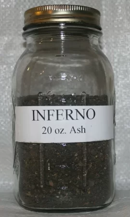

Check First post the results are in for the Inferno's
Hey, I got my first real CLINKER this year(so far) Check photo attachment.
I only have one thing to say about the Inferior's. I mean Inferno's. Not worth wasting your hard earned cash on.
I nominate them for this years MUSHY award. Worst pellet of the year (to date).

Here's a photo to compare the samples.

Thats a big booger!
amick780 said:
Thats a big booger!
Hard as a rock too. I had to really crank the heat on the stove to get any heat from the Inferno's. I am really surprised that it made it through the mixer( auger stirrer ) in my burn pot. I have gotten very small ones, But nothin like this rock!

As impressive as it is, goes to show you how bad those pellets are. I had spied them at our Price Chopper Grocery store for $5.99/bag.....I almost fell over! That was $1.00 off too!!!
