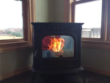

Hey, let the stove run down last night and I just checked damper door and it swings freely. Fines door was shut correctly but I took it off and put it back on and cranked it down tight. Just checked door to igniter and it is sitting down on the wing nuts and tight to the burn pot. Check the pic out. It's not the best but I couldn't get the little video to upload.

How old of stove, date of install? That info should be entered into your signature as it helps others get an idea of things that happen with age related quirks like door gaskets starting to leak more at around five years and pot switches wearing out

2012 model XXV. Self install, no fresh air kit due to plenty of infiltration from old windows. Corner install with one 45 and 4 ft of pellet pipe. Didn't mention cause of pre-cleaning vs post cleaning prob. Point taken though.
