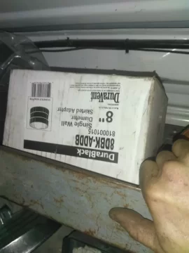

Many stoves of this time period have this issue because they used water pipe which is the wrong size. There are several adapters out there that do the job.
AKA "appliance adapter."
Nope a regular appliance adapter won't fit these stoves.
This is the 8" version I don't have a 6 on the truck right now.

Just get the skirted adapter
Does the adapter open slightly larger than 6”? Also does use of this require using the same brand for the remaining stove pipe? Thanks
The inner part of it fits nicely inside the water pipe collar as it should and the outer part slides over. And no you don't need to use the same brand pipe. It just gets you to standard stove pipe size.
