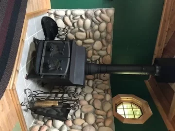

New to this......Is someone able to tell me which model we have? Just bought a cabin with this Fisher stove.
Thanks!

Looks like a Grandma Bear III model . A Grandpa Bear has a 30 inch wide top plate, and i beleive Grandma is 26 inches wide . Nice looking unit .
If the stove meets NFPA 211 requirements for unlisted stoves then would the insurance comp. accept that?
Thank you! We just bought this cabin and our insurance company is saying it should have a UL plate on the back....and if it's too old, the underwriter will recommend replacing it. Um....NO!
Well i can see several probable issues just from that pic. First the 8" stove is reduced to 6" chimney. That violates code and could easily cause performance issues. It does not look like you have enough clearance behind the stove unless that stone is over noncombustible walls or is a proper heat sheild. They will also probably want to know the r value of the hearth and conifm it is big enough. A modern stove would probably address all of those issues and work much better at the same time. And some insurance companies wont care if it doesnt have the ul tag they wont cover it period.
