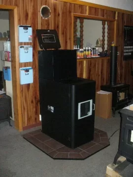

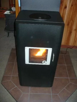

This is the start of the install on my Demo unit Bio-Furnace. It is an Endurance 50F (revision Q) by Fahrenheit of Holland, MI. The link to their website is on my website. All I did today was put the hopper extension on, move it into place, and got the 4" pipe ready to tie into the existing chimney. I do have other things to do than sit on Hearth.com and see how many people I can fire up.
I did have a Breckwell Big E in this spot since April 2007 and the chimney worked great. Yes, I should run a liner but I do not want to at this time and want to see what is going to happen without one. We will be fabricating duct work to this unit and having it heat the main floor, 1,300 sqft. I might tie it into the upstairs but there is construction going on up there right now. I will try to keep you updated on this. I am like a kid waiting for Christmas.... I want to fire this girl up.

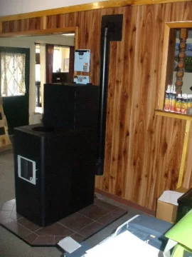

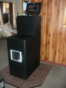

Here are a couple pics of the vent minus the clamps, still waiting on the paint to dry. Been a little busy today, 22 tons of pellets came in this morning and 2 of the 3 forklifts would not start.

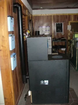

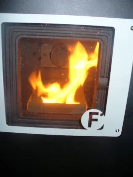

We have ignition!

It has 5 fuel level choices wood pellet, corn with high moisture, corn with low moisture, grains- wheat, and high ash fuels. The self cleaning burn put is the best. Beats the heck out of the little agitator in some stoves.
