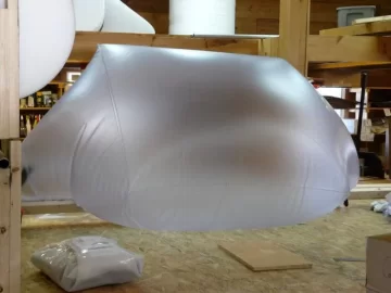

This is what all our liners go through in testing. Should have done this on the first ones that went out. Am now doing it!
All leaks show up in this process.

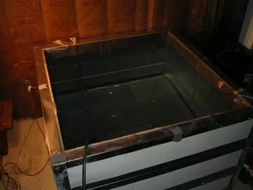

That being said, we have just finished filling your replacement liner in our shop. It looks fine. We will now empty it, dry it out and UPS it, hopefully today.
We had already leak tested it as shown earlier, but I thought filling it was prudent in this case.
