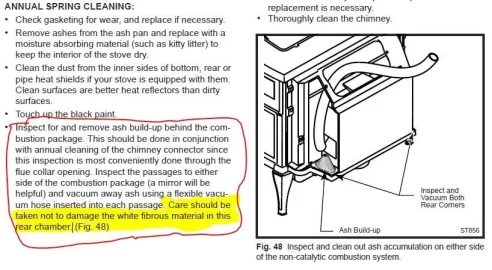

It's the secondary combustion package for the stove. It could be the stove just needs a good cleaning. Do you follow the spring maintenance recommendations?
Yes, I vacuum that area out, but this is way more fundamental. I have to figure the chimney is blocked, but as I mentioned it's no the cap (I was just up there), nor is it immediately under the cap (poked around with a rake). It was swept semi recently, so I'm befuddled, but I'll have it swept and see if they find anything.
