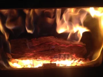

The Ashford has a beautiful fire when you turn it up.
Even on high it'll have longer burn times than a comparably sized non-cat. You won't be disappointed!
  • [Hearth.com] BK Ashford 30.1 and flames
Thanks guys for the replies.
Okay, so correct me if I'm wrong.
I can turn the stove down, and get incredibly long burn times, compared to non cat stoves.
But I can turn it up when I want to see the fire, and it will likely still burn as long as a similar sized non cat stove will on low.
Being a cast iron jacket over a steel box, it won't radiate as much as plain steel, so it won't be as likely to heat me out of the room.
Is that about right?
I'm planning on getting the blowers. Do I need to get an OAK for it because of that? Anyone have the brown enamel?

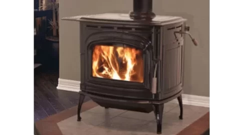

Webby, thanks for the picture.

So it sounds like you like the brown enamel? I couldn't find a picture of the Ashford version of that color. I like it on other brands like Jotul.
Is it holding up okay?

Thanks begreen! It does look good. In the pic you posted, it looks like it has a shelf on the left side.
They offer a side warming shelf. Can't have one on the other side because it would interfere with the bypass operation. Kinda odd looking on one side only to me.

I'm trying to think what I would use the warming shelf for. I would be concerned laying anything on top of the enamel might scratch it.
The brown enamel looks great in person if you click on my profile picture that is my setup in low light it almost looks black. Ours is holding up great no chips yet.
A good enamel job is pretty tough if you don't bang on it or shock a hot surface with cold water. Our enameled Jotul 602 with trivet grate is 32 yrs old. It still looks good.
