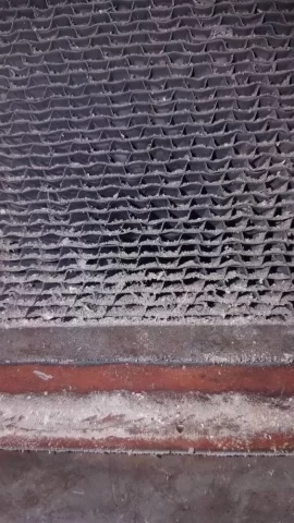

So I ended up pulling the cat out to inspect it better. The front was partly clogged with ash but the back was almost totally plugged. Used the shopvac with brush end and cleaned it all out and its good as new. I didnt have spare cat gasket so just ordered a whole bunch. Night and day difference in terms of heat output and burn level for the same t stat setting though even without a new cat gasket yet. Like cleaning a plugged air filter in a shopvac basically.
This was the front / while still installed. Back was 10x worse.
