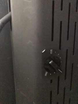

Full load mix Elm Spruce and touch of ponderosa Stove top 400 just to the right of cat. T/stat 4oclock and cat temperature 4oclock fan speed on low. I have a ceiling fan 6ft from insert set on low with winds at 20-30 Mph outside temperature of 30. Not trying to set any record here just need to know How low can your insert T/stat go before the cat stalls?

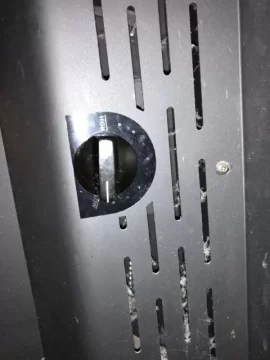

On your dial (t/stat) what setting on your dial is the lowest most of the time? Fully closed?
Yes, fully closed, as far as it turns. Like this.

With full load stove top temp I'm guessing say 450 left or right from the cat and cat cruising 3-5 o'clock fan on or off? Does your stove top maintain say 450 stove top all night? Thanks for the reply
By accident I asked my son to turn down my stove he went all the way closed to low setting I found a new setting that I have been avoiding because of cat stall on my way turning down t/stat.

My bad i always though turning dial all the way shut was off till my son said it reads low not off Dad. Finally I now know why there is a hole in the t/stat flapper live and learn thanks again!
